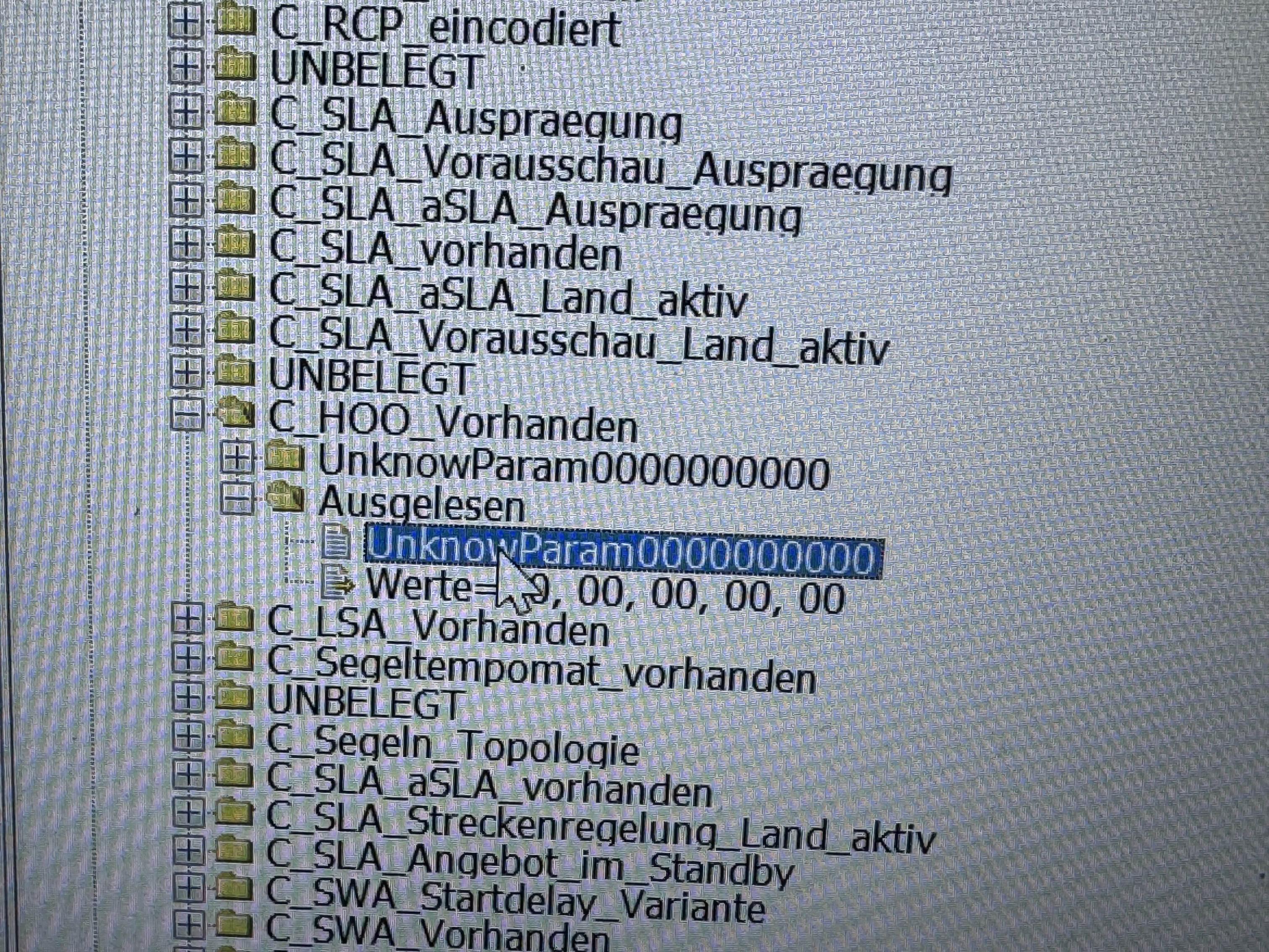

Update: Using the following setup, I was able to read the codes:
E-Sys: 3.35.3
Plus: 3.8.1
PSdZDATA lite: 4.58.15
However, there are no usable values in C_HOO_Vorhanden:
Maybe there is another place to activate the camera? Or I still have the wrong files?
