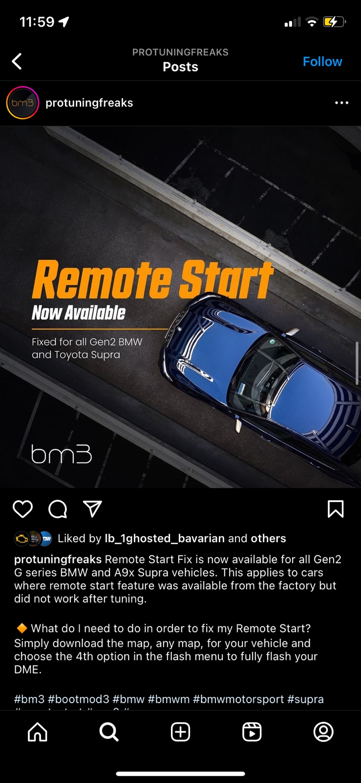

Location: TN
Bootmod3 has a fix for remote start now FYI. Not sure if that helps OffK but still good info.
