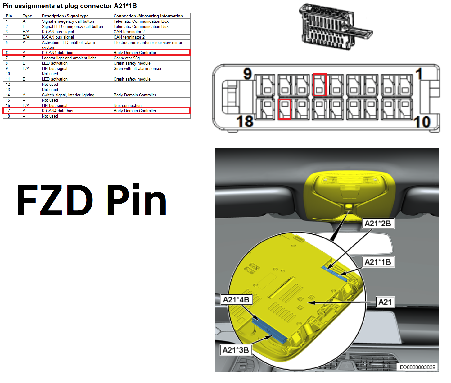

(G20 DIY) Gesture Control (VO 6U8)

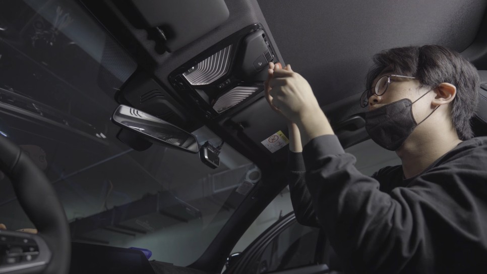

My G20 was not Gesture Control. (Now Can Gesture Control)
Can Retrofit Gesture Control.
Need 2 Wiring and FZD Module. (with Esys Coding)
-Parts Number-
FZD Module with Gesture Control
61319483615
61319460012
61319893141
61316986144
61319875363
61317910960
61315A0F616
61315A25179 - One of These

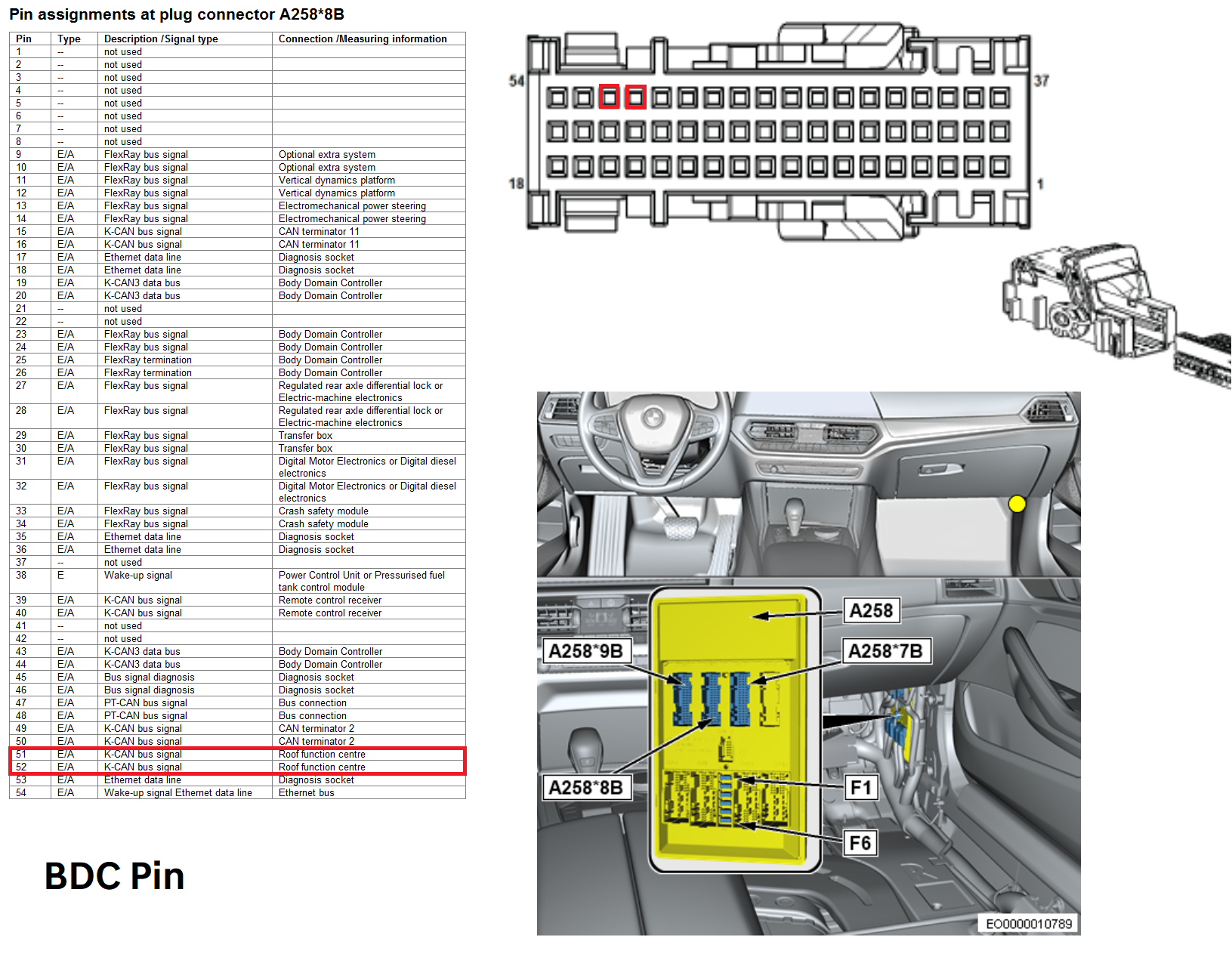

FZD Pin
61139230107 - NanoMQS 0.22-0.35mm
BDC Pin
61131383776 - MQS 0.2-0.35mm
-Need Tools-
Trim Remover
IWISS Press Tool
Star Wrench T15
Star Wrench T20
*Torque Tools (preferbly to have)
-Main DIY-

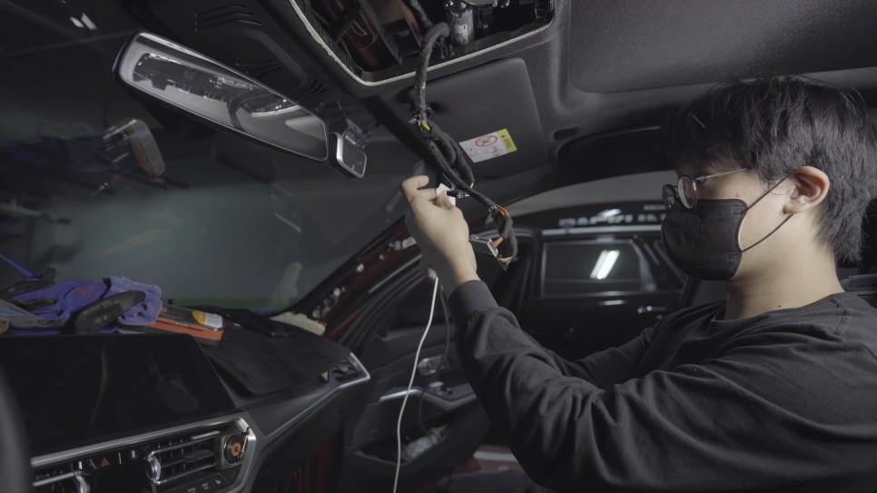

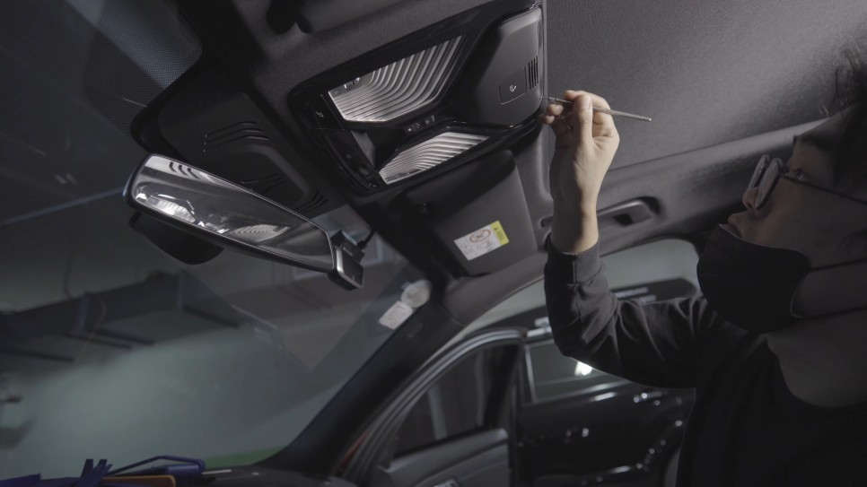

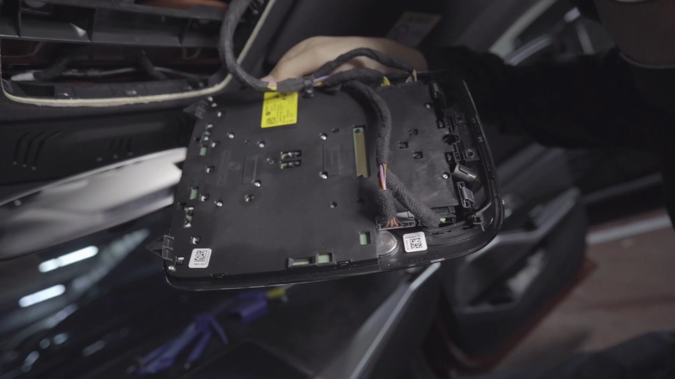

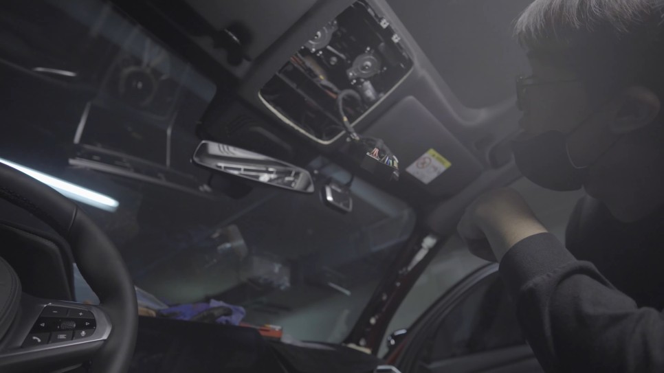

1. Removal FZD Module
2. Make Wire
3. Change FZD Module
4. VO Coding

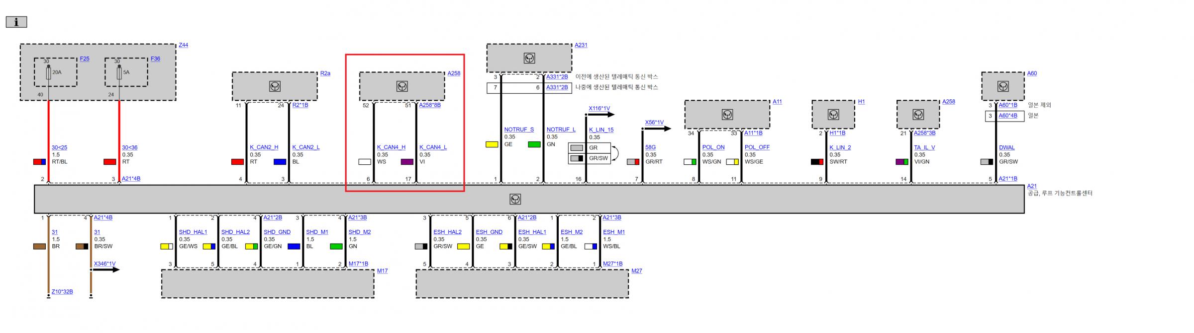

-Wiring-
Check Image
Go DIY (watch my video or repair guide)
(I'm so sorry... video is not Eng sub. only Korean)
Check PDF File or Video

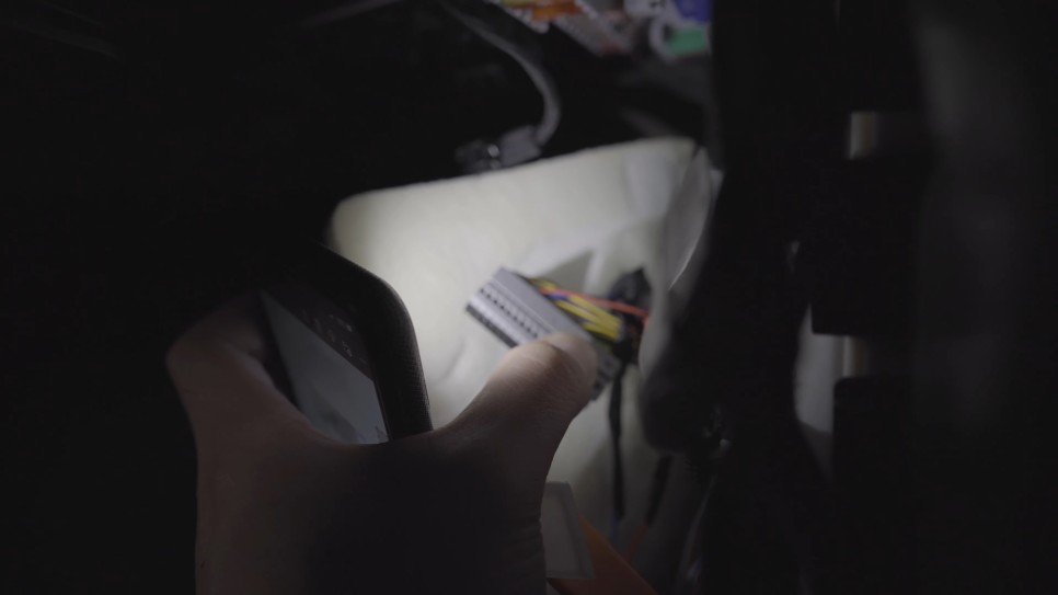

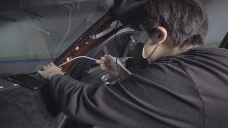

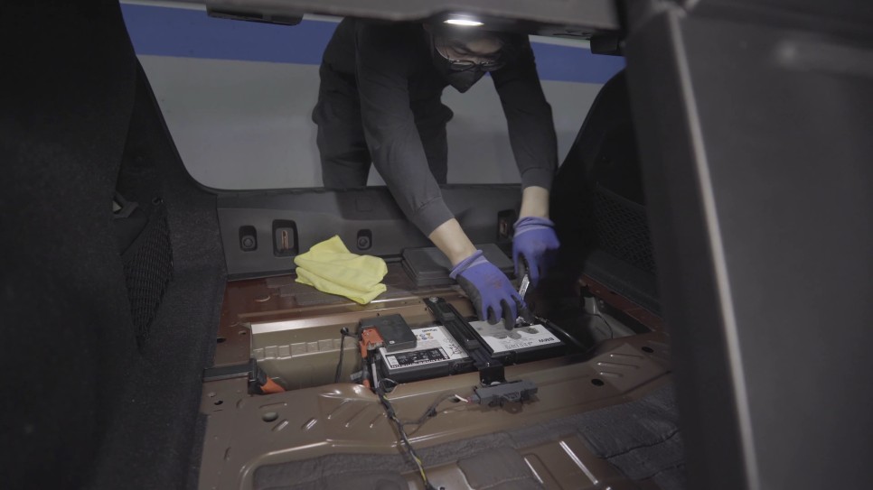

1. Remove FZD Module

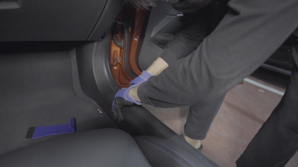

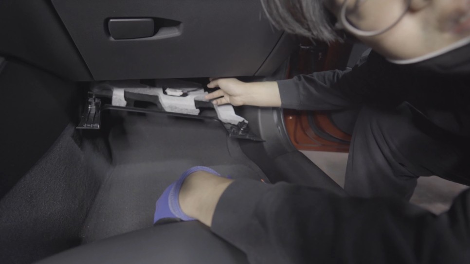

2. Remove A Pillar Trim & BDC Cover
3. Make Wire FZD to BDC
4. Assemble New FZD Module
5. Add VO 6U8
5. BDC, MGU, FZD Code or Flashing
(Maybe no need BDC Code)

Great write up where do you get your circuit diagrams from? I am trying to retrofit Harman Kardon Surround speakers located in the D pillar of my 2019 Australian spec G05 X5 The cables for the speakers go into the RAM ECU and would like to know which are the correct pins to use.
ISTA or newtis. I remember there was a Harman Kardon wiring diagram.

I looked at this retrofit option in my X5 but in my case it is a lot more complicated in that you need to run 2 additional canbus wires to the main BCM module for the car to recognise the camera in addition to the coding. If you have already done this make sure the pins are connected in the correct position and not the wrong way around.

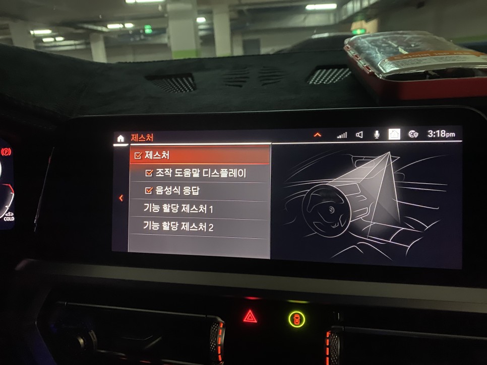

Thank you for the DIY brother. I just done it. Here is the FDL for people who dont want to VO the MGU :
Gesture_Camera : aktiv
Gesture_Camera_Two_Gesture : aktiv_original
This is For G20 :
Proximity_X : -235, -325
Proximity_Y : +145, -120
Proximity_Z : -340, -430
BDC does not need to be coded. Cheers.
