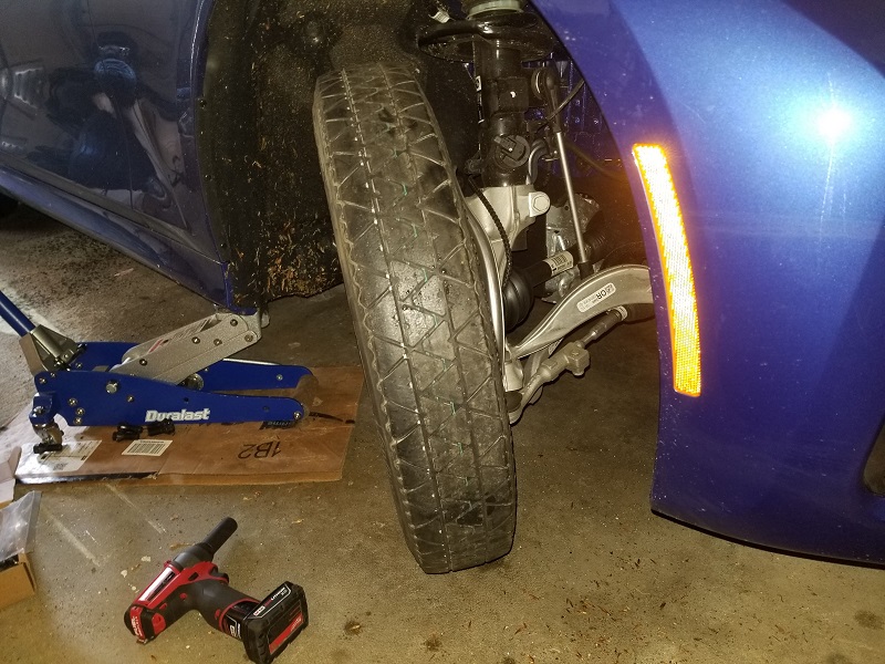

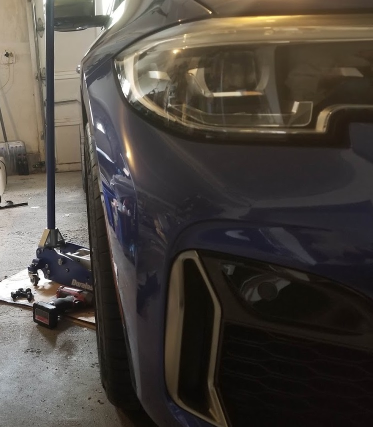

As you might now, the M340i cars optioned with ZTK do not come with the space saver spare, as the 18" donut that comes with the lesser G20s does not fit over the larger brakes that come with the ZTK package. Well, guess what: Audi makes a 19" spare in the same 5x112mm bolt pattern with the same 66.6mm bore diameter, with the correct rolling diameter. This is the A4/S4/A5 spare, 125x70R19 tire on a 19x4" wheel. It bolts right up, fits over the brakes, but touches the front of the fat caliper. A 15mm spacer to the rescue! Problem solved.
And you don't lose a lot of usable trunk space either, as you can actually fit stuff like grocery bags inside the spare, lol...

These are the spacers I got:
https://www.ebay.com/itm/Pair-Of-15m...53.m2749.l2649
Hubcentric, comes with the correct length bolts, everything seems to be of decent quality.

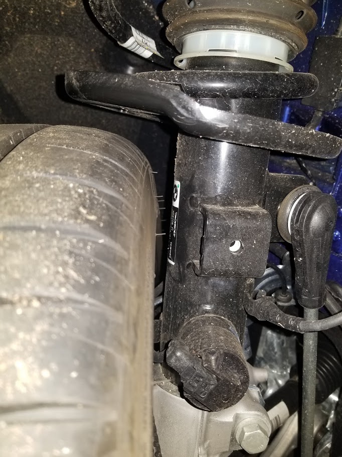

Yes looks like square 255 setup is possible. I actually tried test fitting one rear wheel up front, and it touches the strut as is. With the same 15mm spacer, it bots on fine, with around 9mm of strut clearance measured at the closest point with the car jacked up. With the car dropped to the ground, I'd say it sticks out a little bit too much. Doesn't appear to be rubbing anywhere at full lock. I didn't drive around like this though. This is a 19x8.5 ET40 wheel, so a 15mm spacer effectively makes it ET25. I think ET30 (or a 10mm spacer) would be ideal. But you never know till you try...

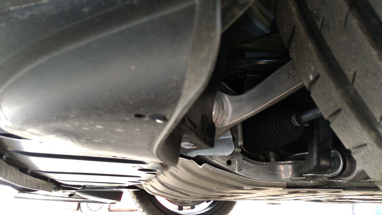

Was there originally some plastic shield for oil cooling radiator, as on M3/M4?
Life is not measured by the number of breaths you take but by the moments that take your breath away...
      08-01-2019, 07:55 PM   #12
Ilyam5
971
1,098
Drives: 06 M3
Join Date: Jul 2007
Location: ma
Originally Posted by Delija View Post
Ilyam5
No - it is bare. I had to manufacture my own shield since IND does not have one.

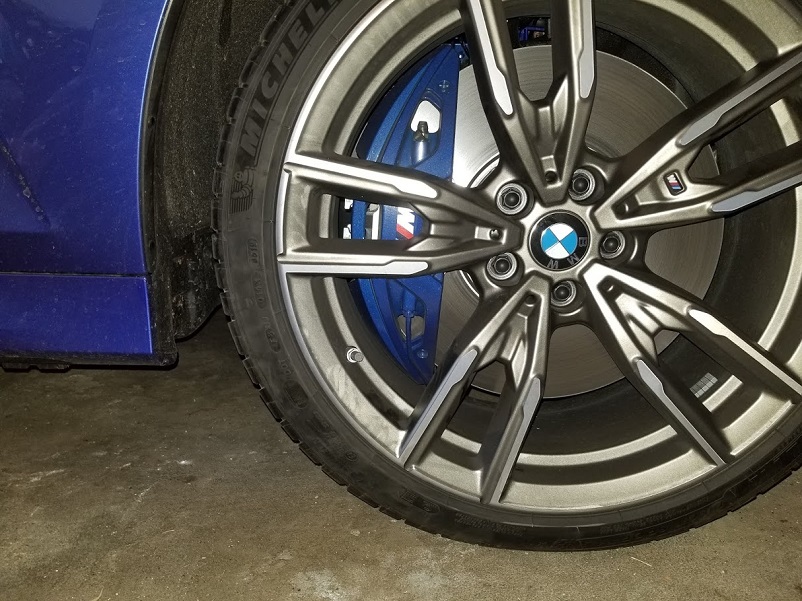

Hi! I think the 19 inch wheel barely fit the 374mm rotor. I think it is dangerous. If small rock and debrib get caught in there, it will scratch the wheel. And it does not look good. I think 374mm needs 20 inch wheel like G30's.
Also I saw you posted pic on another thread. These 2 photos both are your car, the same brake rotor? It seems the first rotor is smaller than the second one. The second one barely fit..

M Sport brakes on F30 have 370 mm front rotors and they work just fine with 18" wheels.
Same car, same rotors. Must be a funny angle.
