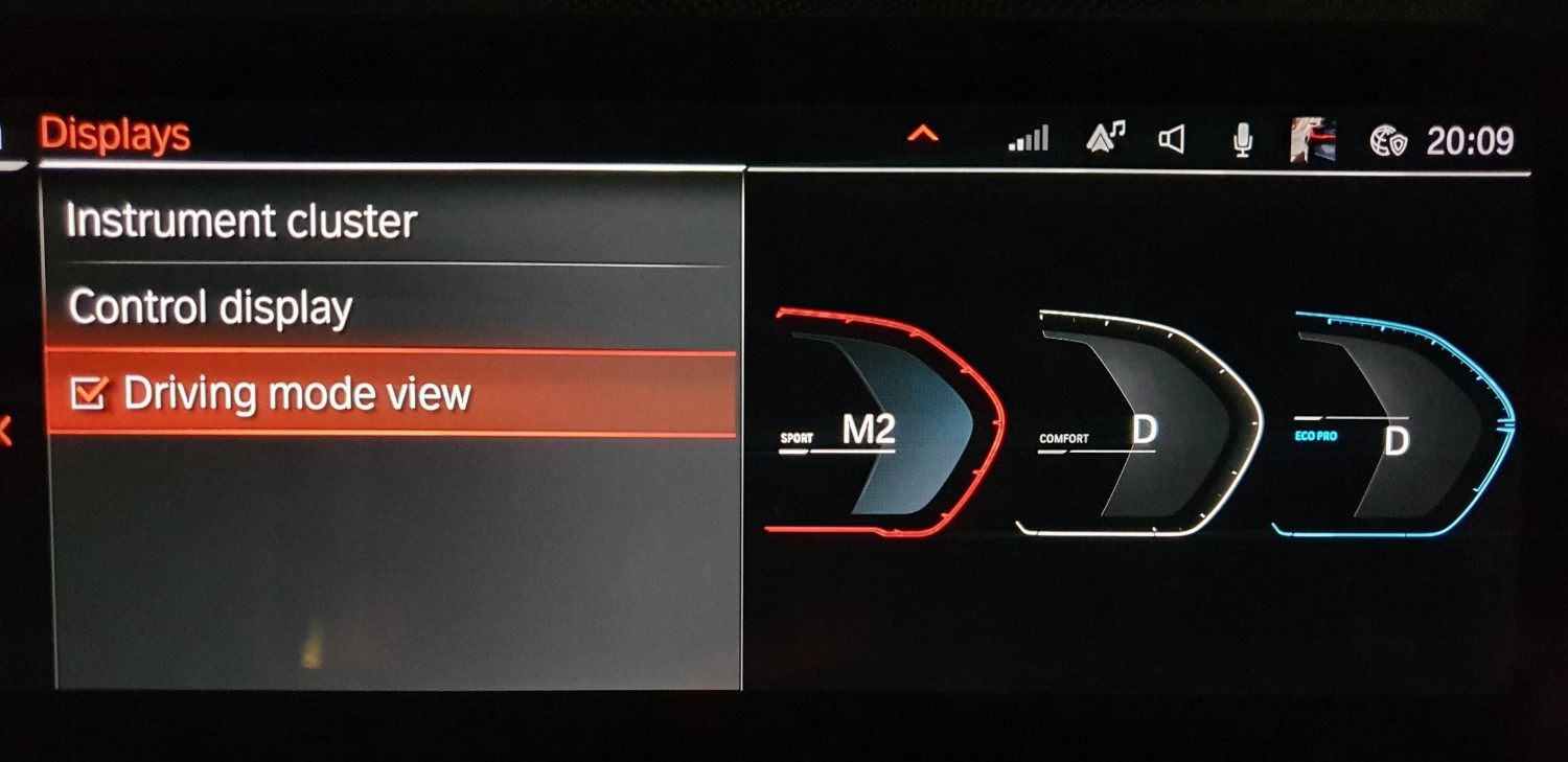

Here is how to change the color :
HU_MGU -> VEHICLE_COLOUR
Here is how to change the trim line model (sport, regular, other) :
HU_MGU -> TRIM_LINE
And for the driving mode view, verify you have selected this option in the iDrive :
Name:  driving modes setting.jpg

Thank you, I will try it later and report. As for now, I checked the offline Version of Bimmerutility and trim line is showing me a lot of options, which are exclusively for exterior trim lines. Like my m sport package. Are they linked to the driving modes?
Because I am missing the Eco Driving Mode in the instrument cluster. When I switch to eco mode nothing changes, same colors and same design like the standard comfort mode. When switched to sport, the instrument cluster switches to red and the right gauge changes from percentage to rpm.

I can report that changing the vehicle color did the trick. Thank you very much.
As for the Driving Modes, vo coding HU_MGU and BDC_BODY2 (it is only showing this one) did not help. I am starting to think that there is no other “style” for the instrument cluster in eco mode. I even reset the HEADUNIT via ISTA today and it did not help.
Can anyone confirm that there are no changes in the BMW Live Cockpit Pro on a PHEV G30 when switching from comfort to eco mode? Or are there other options which I could try?

Have you VO-Code the 7083 CAFD, in BDC_BODY2?
To change the wheel and trim, try to change this line :
HU_MGU -> TRIM_LINE

In fact, it's definitely not normal if you don't see the current driving mode in your instrument cluster, regardless of whether the display style changes or not.
Can you explain how you VO-coded your BDC? It's because the BDC contains several different CAFDs (Controlled Driving Devices). You need to make sure you VO-coded the correct one. If you're unsure, select them one by one and then VO-code them.
If you use BimmerUtility, you can send me your BUP file (a complete backup of your CAFDs) so I can take a look at it...
