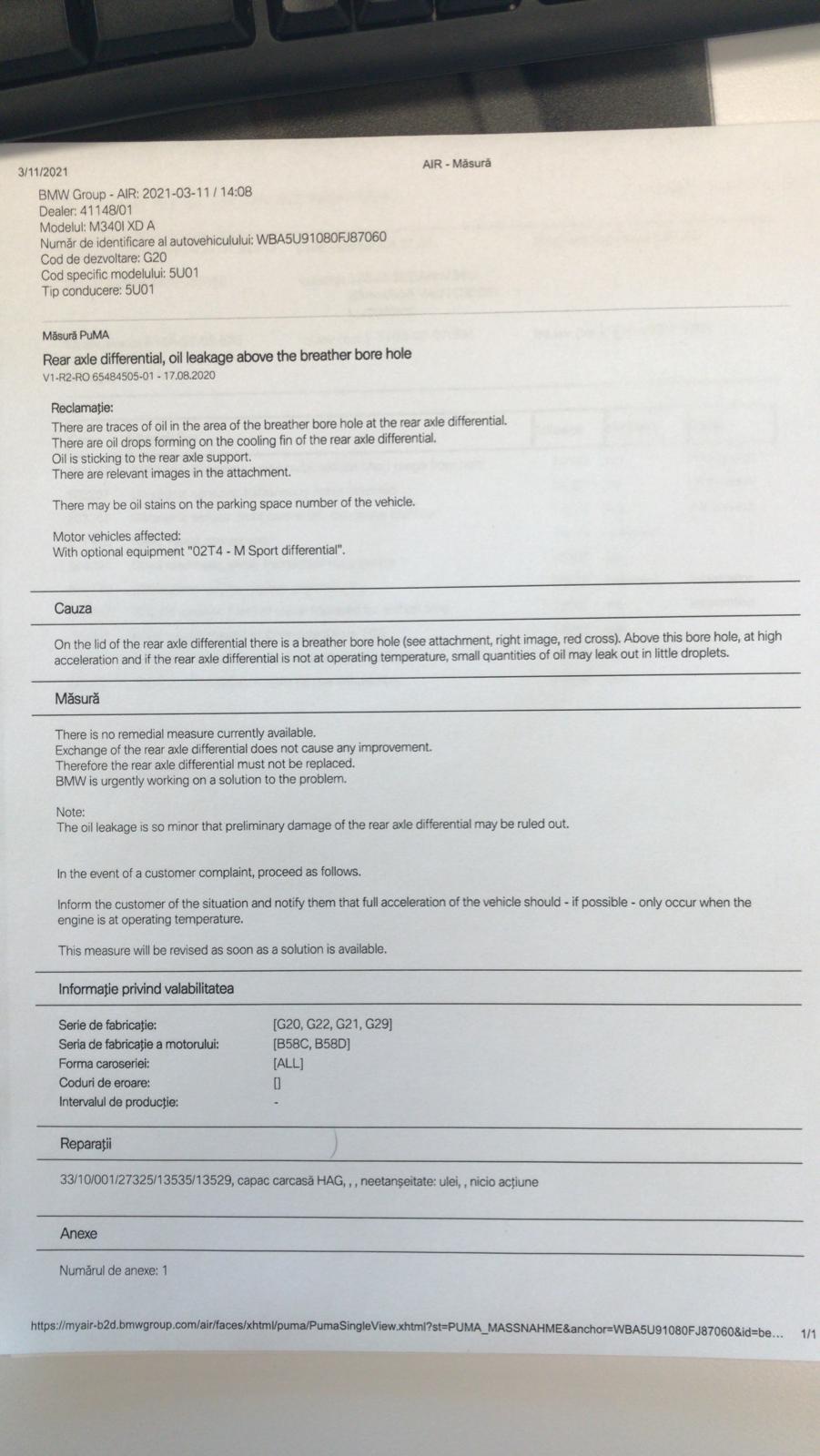

Alright, hope this thread isn't dead. Did anyone solve this problem in the end?
Mine is still leaking after rechanging the fluid at the dealership. They said it's from the breather hole at the top of the differential and that I shouldn't worry about it because it is minimal and it can't cause damage to the differential. They even gave me a report from BMW about the problem, so it seems like they are aware of it. I'll post it here so you guys can read it as well.
Let me know if anybody still has this problem and how they are coping with it.

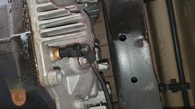

I just got my car back from the dealer for the diff leaking. They sprayed the entire thing down with tracing powder. Told me to bring it back in 250 miles. So I did. They found that the drain plug was leaking so they topped off the fluid and replaced the drain plug. They put tracing powder on it again. Been 2 days and no leak yet but I will monitor it.

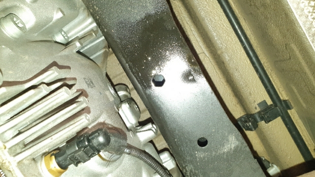

Update: I see fresh fluid on the subframe, however not on the diff anymore. Sent pictures to the service advisor and he said to bring the car back again tomorrow.

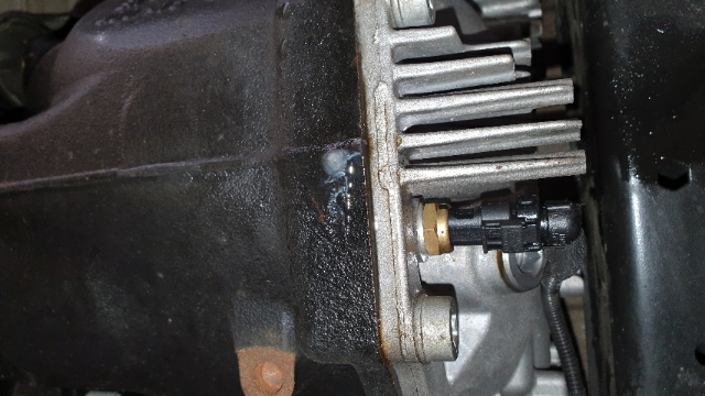

I’ve had this leak for over a year and I ignored it based on this thread saying it’s a, “BMW thing”. It’s usually just a few drips here and there after hard driving, but perhaps the leak has gotten worse just recently?
So I go for regular interval service and the dealer flags it during their inspection as a warranty repair. They’ve had the car for three days waiting for a replacement part to arrive. I’ll edit this post once I get my car back and learn what part was replaced… maybe the issue was elevated to a TSB and there’s an official fix for it.

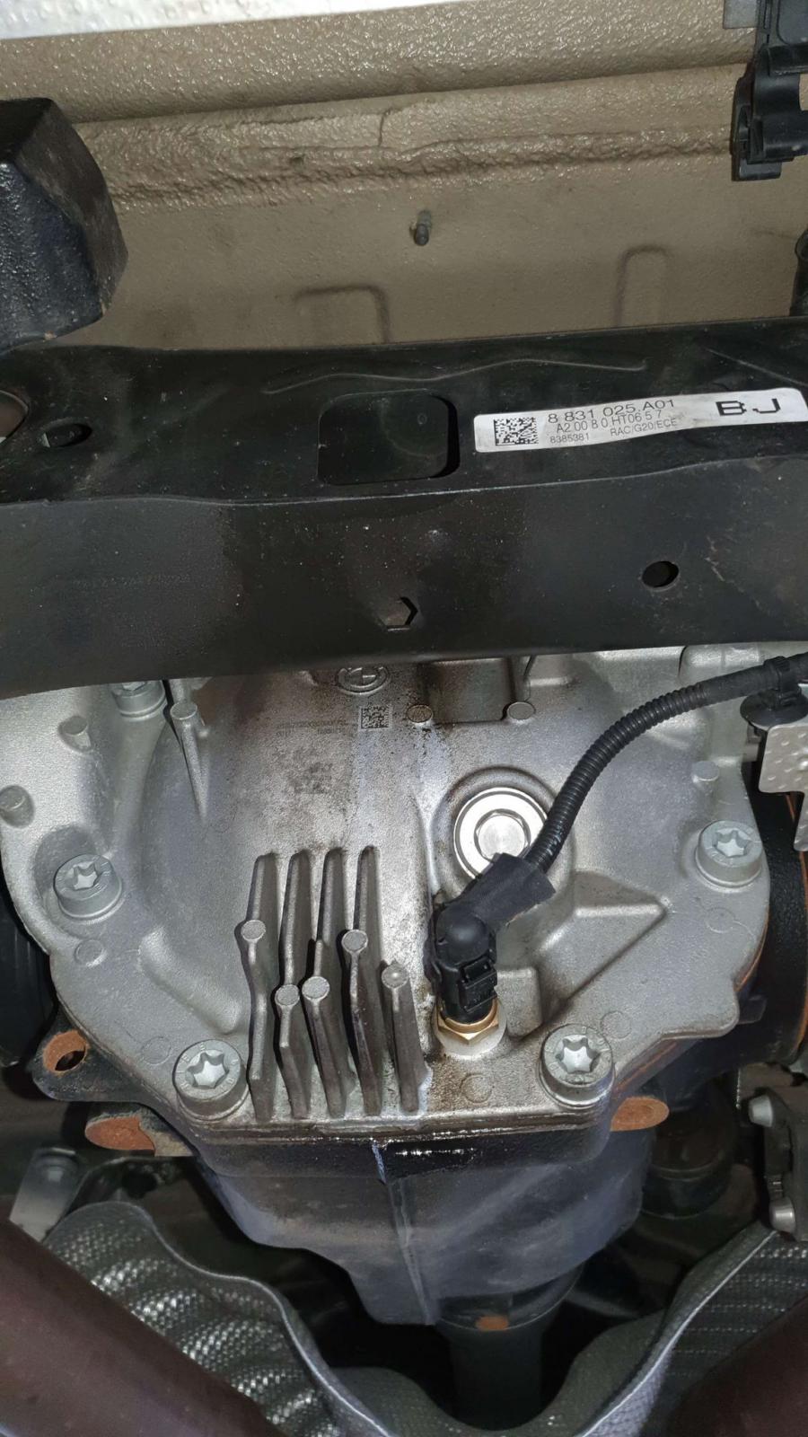

I had a decent size stain on my floor from the rear diff leak. I took it to the dealer and after 3 hours, they said they wiped it clean and said its normal. A leaking diff is not normal. If it happens again, which it will, I will be taking it back until its addressed.
Sounds like some members here got there's replaced or had some of the case replaced.

I've been the dealer 3 times. The oil is blowing onto the subframe from the diff's breather holes on top. They won't acknowledge the issue and says there's no leak coming from the diff itself.

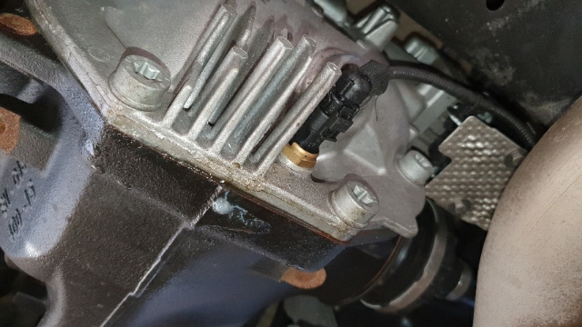

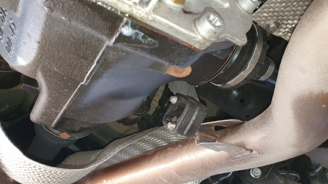

My service adviser notified me that the leak was coming from both the drive shaft and wheel axle connection points to the differential. This is a bit worrying to me... but hoping the fix does the job. If they're replacing a defective part for the same part, it stands to reason the part will fail again? One of the parts is labeled "repair kit", so perhaps there's a known issue and this is meant to repair it. I will be looking for fresh fluid on my garage floor in the future but will be driving her easy for a while just in case the replacement parts need time to settle in. As others have stated, I only ever notice drops on my floor after spirited driving.
Here's the bill of materials for the work performed:
3 - 83-22-2-447-362 - HYPOID AXLE BMMI
1 - 83-19-0-404-517 - LOCTITE 5970 01BCMB
1 - 33-11-7-525-064 - SCREW PLUG W BMBIMI
2 - 33-10-7-568-368 - GASKET SET D BMRRSA
1 - 33-12-7-607-158 - REPAIR KIT I BMMIRR
