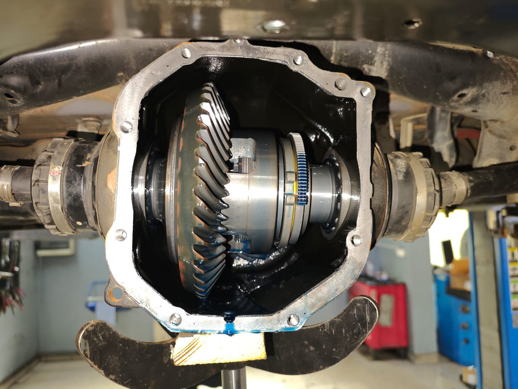

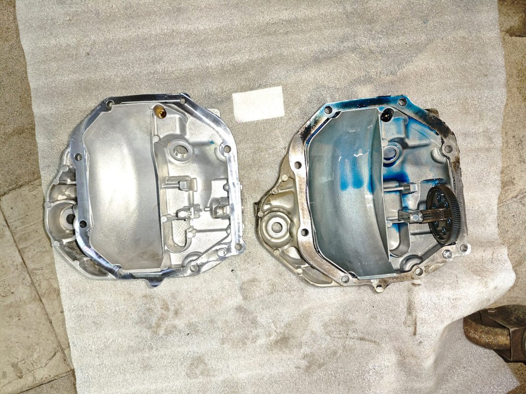

how to replace the rear differential cover
I replaced the rear differential cover
the new one is improved,
you can do it yourself
part number 33118677753
old number 8677754 (from my car)
new number 8677754
upload photo

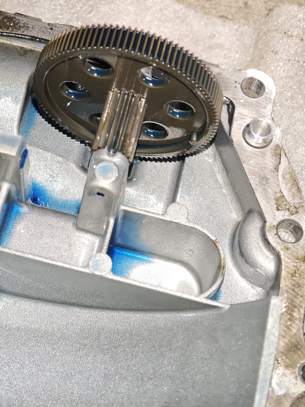

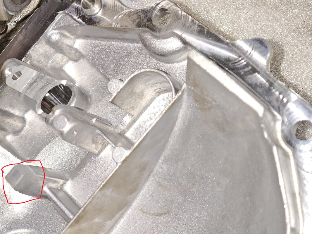

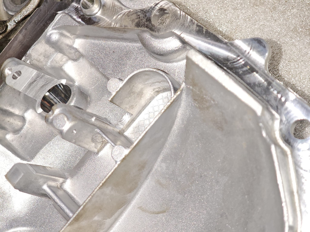

      04-14-2025, 09:22 AM   #107
sanczo17@wp.pl
11
18
Drives: BMW G42 M240
Join Date: Oct 2023
a small tip when inserting the differential cover it must slide into the right place I marked in the pictures
you will see it through the filler hole if you put it in correctly
      04-28-2025, 12:22 PM   #108
infinite_creations25
147
193
Drives: 2026 BMW M3 Comp xDrive
Join Date: Jan 2017
Location: Canada
I finally got around to replacing the cover. Oil is no longer spraying out from the vent anymore.
Process was pretty easy and straightforward. I can confirm that there is no recalibration needed after installing the new cover. As mentioned, it is very important that the tab on the cover is aligned with the groove on the LSD assembly. Thanks to @sanczo17@wp.pl for the detailed pics.
