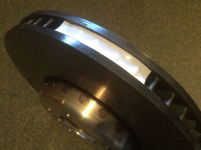

Join Date: Mar 2007
Location: Scotland, Highland Region
My thinking... I look at the picture and try and understand the reason for what appears like jets of air to the rim. Count the venting vanes in the disc, I wager they match the air pulse marks in the dirt on the rim.
As I see it.. the air flow through the disc is acting like a turbine, possibly restricting, even 'compressing' the air as it passes through the caliper housing. As the vanes reach the end of the caliper, the air pulses out into open space. The rim size could be restricting the flow and generating the sound track. May be a bit more to it, like the shape or rigidity of the backing plate, also involved in way the air is restricted and/or dispersed.
      01-14-2020, 03:56 AM   #168
clausmoll
75

Another thought.
Looking at RealOEM, it appears the latest sport caliper (G20) is a different shape than the F30, looks like a longer 'wrapped' form. Could be relevant in the air build up in the restricted space.
Incidentally I run 17" winter rims on my car, it also has 348x36 discs. So space is just as restricted. My wheels get filthy inside, never ever seen any marks, which indicate a strange air flow from the brakes. What is different, my calipers are the standard floating type, quite open in design, although only about 6mm clearance to the inner rim.
BTW, I've got a Brembo 348x36 disc here in my office, it has 48 venting fins, 24+24. One solid, one slotted, alternating around the disc. Assuming the G21 discs are the same, we have 24 'inlets', I expect there are 24 marks in the dirt.

Here's a way to temporarily eliminate the airflow. Not recommending anyone take it on, but I know I would.
Wrap the vented area with insulation tape, a couple of times around the disc, make sure its contained in the area between the disc faces. Try a careful drive, get to the speeds where there is normally a problem. Just don't brake hard and heat the discs too much.
      01-14-2020, 05:10 AM   #172
clausmoll
75
100
Drives: 330i Touring M-sport
Join Date: Nov 2019
Location: DK
Tempting...

I would, if I had the car
Okay - I did it. It took 20 minutes out of my lunch break.
There was no difference in the noise what so ever. But I do still suspect the calipers/brake plate/wheel size theory.
Wow! You are the man. Well done!
At least the test eliminates it being directly related to 'generated' airflow from the disc/caliper combination.
I agree there could still be an issue due to something about the complete assembly. Trying 19" wheels has to be specifically tested, it is a process of elimination.
