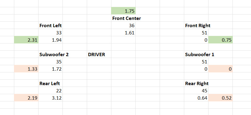

Originally Posted by Greekstyle View Post
Anyone have any pointers/tips to get a higher/wider soundstage?
I believe that the soundstage can be changed using the delay/distance adjustments in the TIME menu. Each speaker can be given its own delay value so that the sound from all speakers will arrive at the driver's position at the same time, creating a coherent soundstage.
When I measure the distances between my head and the speaker locations and enter those into the DSP, I get a soundstage that is directly in front of me, which I particularly did not like. So when I received a couple of tunes to try from Bimmertech, I immediately noticed a change in the soundstage. It was more immersive and didn't sound like it was coming from a single point in front of me. I liked it much better.
The graphic below shows the speaker locations in relation to the driver. The whole number beneath each speaker name is the distance I measured between my head and the speaker in inches. The number below the distance is the delay that the software calculated for each distance in milliseconds. The Rear Right and the Subwoofer Right are the farthest away from so they have zero delay. The other speakers are closer to me so they are given delay values so that they arrive at my head at the same time as the Rear Right and Subwoofer Right signal. And this resulted in a soundstage directly in front of me.
The highlighted numbers are the delay values in the Bimmertech tune that created a more immersive sound. The delay for the Front L, Front R and Front Center signals have been slightly increased (thereby "pushing" out these speakers spatially). The delay of the Rear L and R and Subwoofers have been slightly reduced (pulling those signals closer to the listener). I think this is the main reason for the apparent change in soundstage.
There are other things within the tune that probably contribute, most notably the gain adjustments on each output channel but I don't have enough knowledge to get a handle on all of these different variables and am just making the best guess possible.

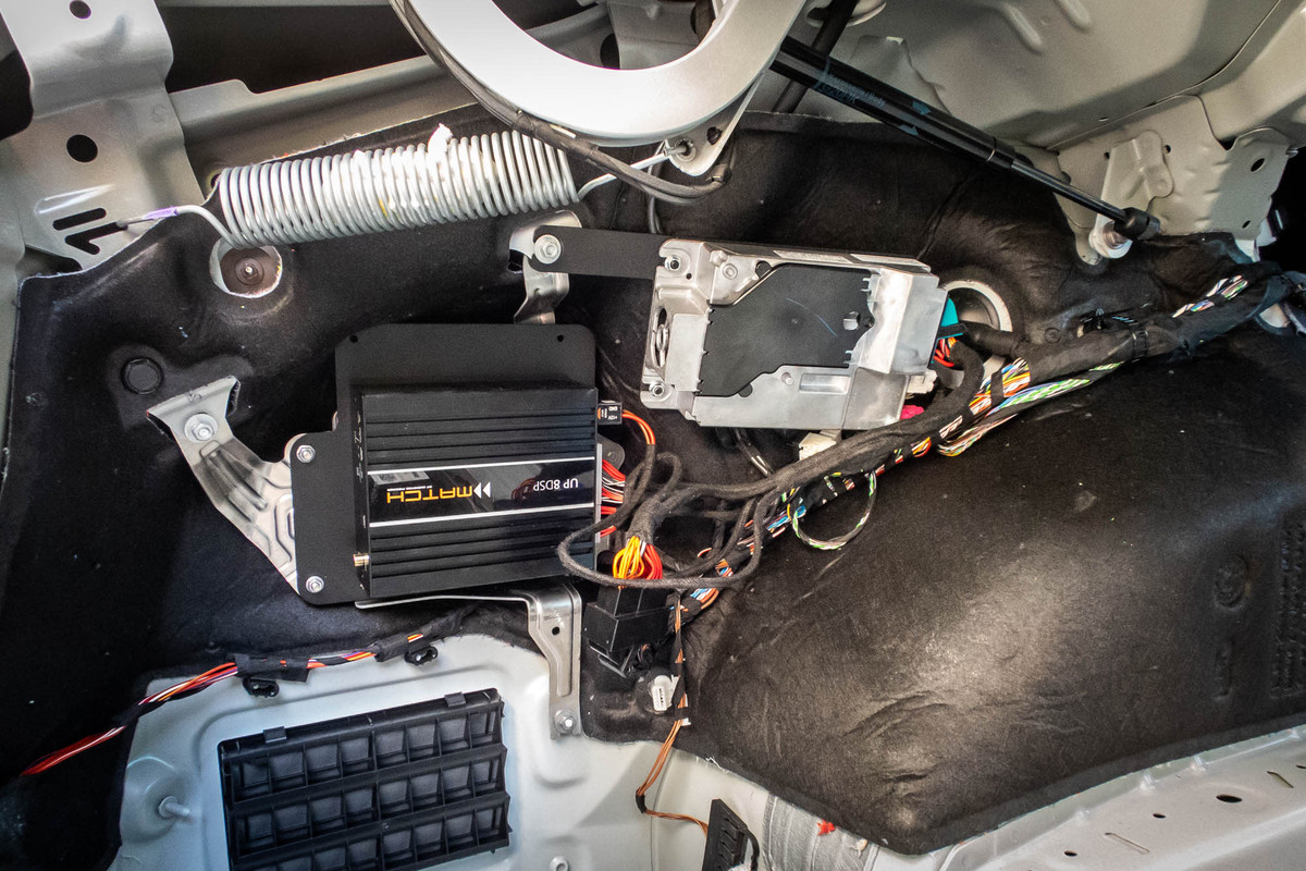

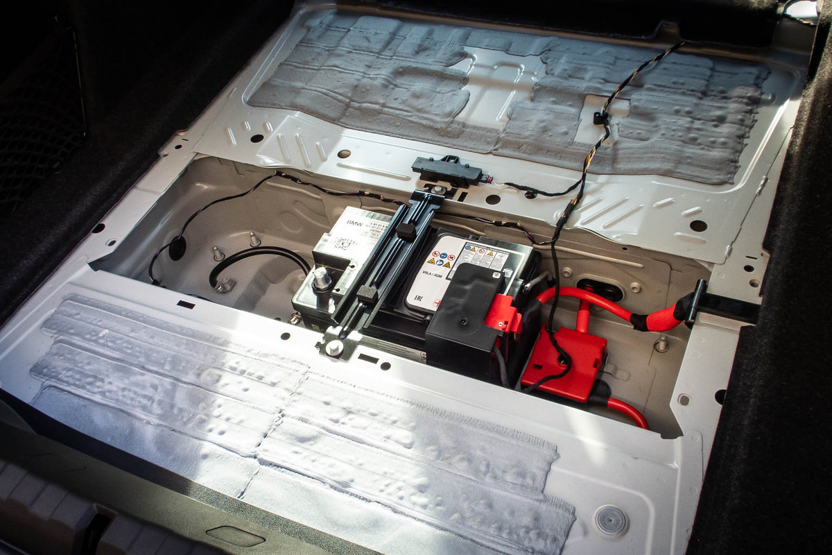

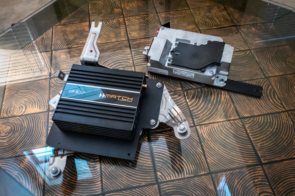

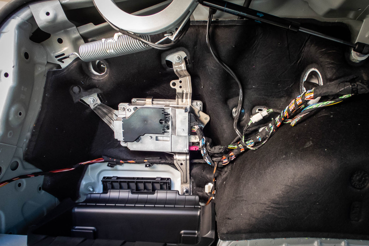

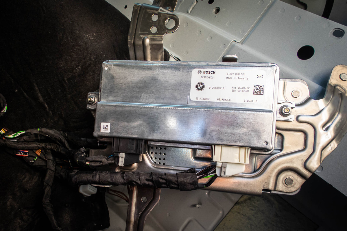

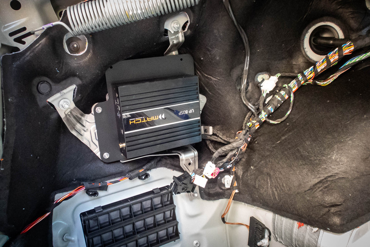

Originally Posted by Thunnus64 View Post
Here are some photos of the installation. For reference, this is a 2024 330i with the HiFi 676 audio system.
The negative terminal for the battery is disconnected for safety.
Here is my RAM unit before any wires are disconnected.
The RAM bracket also holds the ECU for the cameras so some additional wiring harnesses need to disconnected in order to remove the RAM bracket.
The RAM unit is removed from the OEM bracket and is relocated to the Bimmertech bracket. The Match UP8 is screwed into place on the OEM RAM bracket.
I positioned the Match UP8 first. The OCD part of me really wanted the MATCH logo to be right side up but the wiring harnesses aren't long enough.
The RAM unit is then screwed into position and all of the wiring is connected. The green indicator light on the Match UP8 lit up as soon as the wiring was completed.
I fired up the audio before putting the trunk pieces back on just to verify that the amp was working and all is good. Gotta load some tunes and fiddle with the PC-Tools app but this is an amazing upgrade considering the new amp is powering the OEM speakers.
Where did you buy the bimmertech bracket?
I got lucky! I bought it from a Bimmerpost member through the classifeds. Bimmertech bracket + wiring harness + pair of Alpha One A90 under-seat woofers for a very good price!
