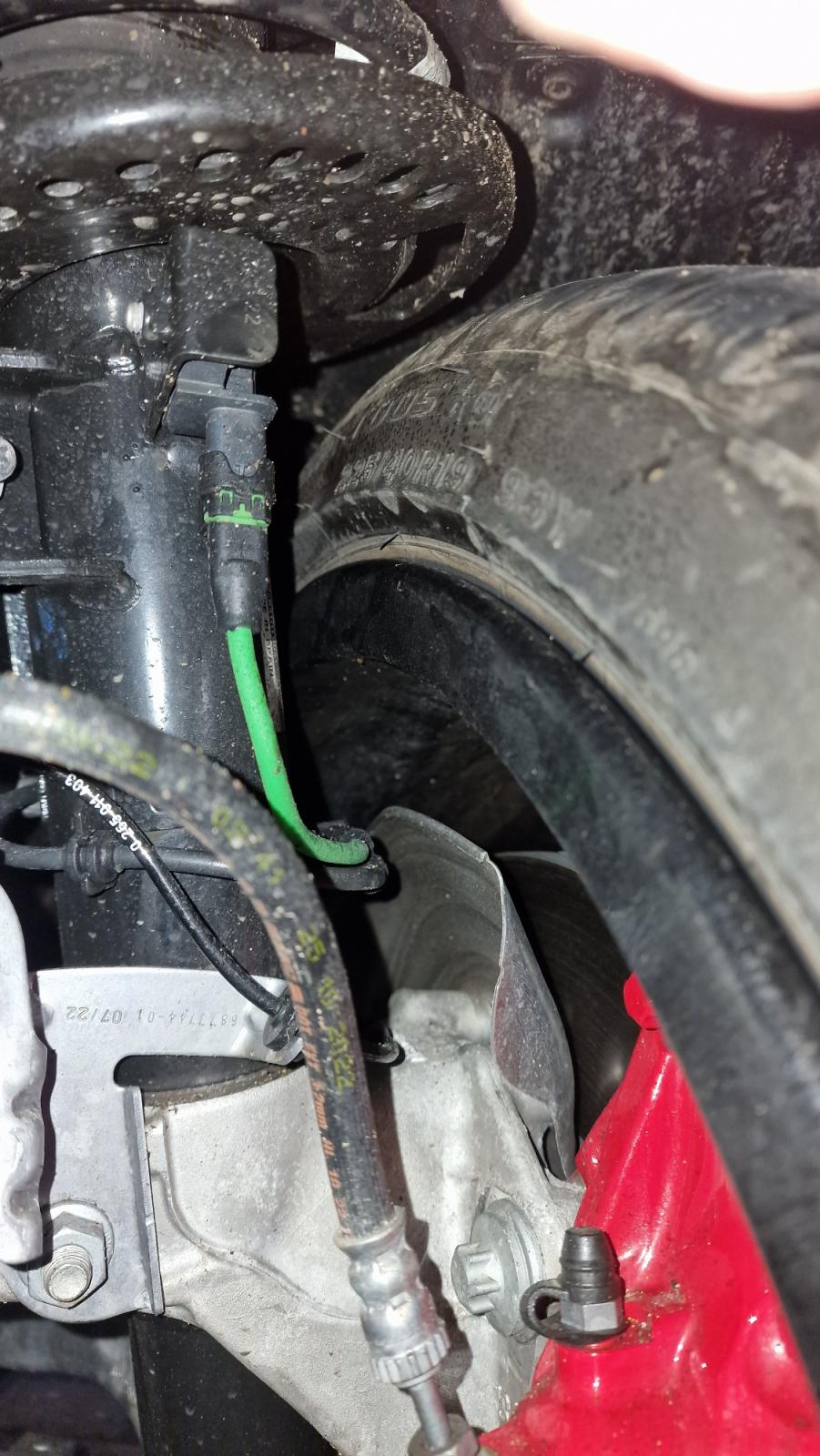

I have attached photos showing the display screen options under Sport mode. The dampers do have wires coming out of them front and rear of each damper.
I'm just not understanding that if i have the M adaptive suspension option paid for (sadly I dont have access to a VIN decoder), but no button on the console to activate adaptive, and no option in the display screen, how am I supposed to select adaptive mode?

Yes you definitely have adaptive suspension. Proof in the dampers themselves. Plus the the damper Comfort or Sport option is there, as shown in the image.
Adaptive Mode is not a function in LCI models, but you have "continuously adapting" suspension, what you paid for. Just select your choice, Comfort or Sport mode, or select personal preferences in Sport Individual.
