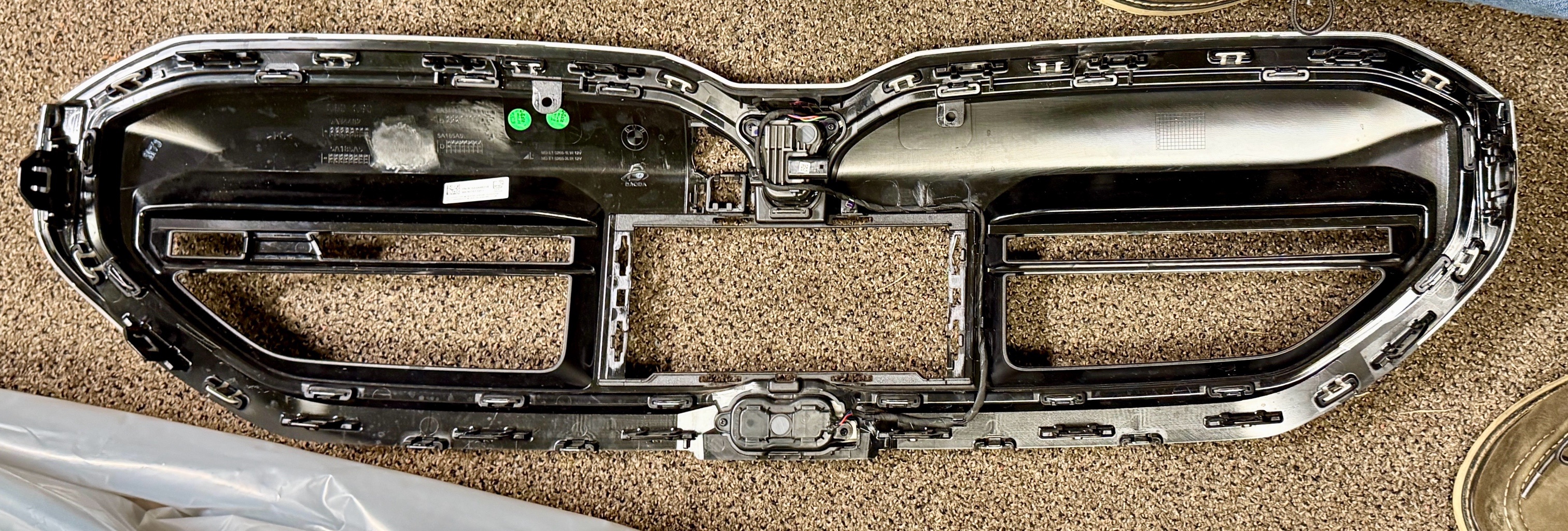

2024 BMW M340xi  [9.67]
I’ve sourced an OEM LED grille from a G28- which is a long wheelbase version of the i3 using the G platform, and is only sold in China. This says it is arriving tomorrow, so I’ll keep everyone updated on how that goes. Not sure what I’m getting myself into, but that’s why I do what I do!
I have the aftermarket one as well, so I’ll at least be able to take some pics and show the difference between that and OEM. The aftermarket ones seemed a bit brighter than the sleek, OEM ones… hence my journey to find G28 parts.

I wish I could be more of a help- I am in my busy season at work and have not gotten to mess with this.
I will share some updated pics of the OEM grille components, as well as the results of some research that I have been doing.
From what I’ve translated online, the best assistance available is the G30 Iconic Glow retrofit and harness kit (BMW 63172466430/631724666465) along with the instructions from BMW that are available.
I also have the G20 pre-LCI Iconic Glow kit, which I may end up using the wiring harness & button from (BMW 63172468335).
Lastly, I do plan to swap in my OEM honeycomb mesh, essentially just using the LED frame from the G28 grille.
Either way, there may be some re-pin work and definitely coding… which I am an absolute beginner with.
Side note- I have also acquired a used G30 grille, which has a portion of the wiring harness… maybe that will help too? We will see. Right now, it is essentially a parts pile waiting for someone to put the puzzle together.
One of us will figure out the wiring soon enough! I wish they made it easier- I think it is odd that there isn’t a clear wiring harness associated with this on our platform, especially since these grilles have been available on G2x models for a couple of years now in China.
Let me know if there is anything else I can show that anyone would like to see. Sorry for all the pics and random info- I hope it helps someone, somehow.
